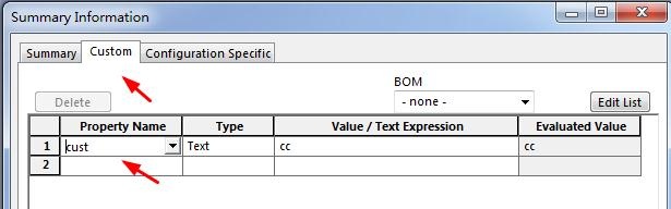

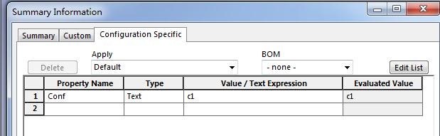

delete Custom and Configuration Specific
delete Custom specific code is
Private Sub t0831()
  Dim swModel As ModelDoc2
    Set swModel = Application.SldWorks.ActiveDoc
  Dim CustArr
    CustArr = swModel.GetCustomInfoNames
    For ii = 0 To UBound(CustArr)
      swModel.DeleteCustomInfo2 "", CustArr(ii)
    Next ii
End Sub
Private Sub t0831()
  Dim CustArr
    Next ii    ''
End Sub
Private Sub test0831()
  Dim SwConfMgr As ConfigurationManager
    Set SwConfMgr = swModel.ConfigurationManager
  Dim SwCustMgr As CustomPropertyManager, PropArr
  Dim SwConf As Configuration, ConfArr
    ConfArr = swModel.GetConfigurationNames
  Dim CustArr, valOut As String, resolvedValOut As String
    Set SwConf = swModel.GetActiveConfiguration
    Set SwCustMgr = SwConf.CustomPropertyManager
    CustArr = SwCustMgr.GetNames
    For ii = 0 To UBound(ConfArr)
      'SwCustMgr.Delete CustArr(ii)
      Set SwConf = swModel.GetConfigurationByName(ConfArr(ii))
      'Stop
      For jj = 0 To UBound(CustArr)
         SwCustMgr.Get2 CustArr(jj), valOut, resolvedValOut
         Debug.Print SwConf.Name, CustArr(jj), valOut, resolvedValOut
         'Stop
      Next jj
    Next ii      ''
End Sub
