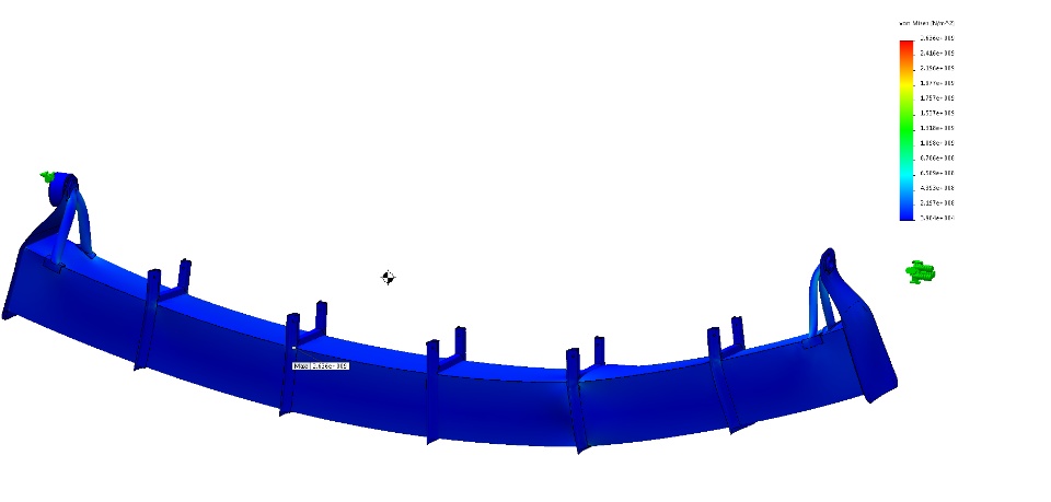

I'm trying to troubleshoot strange behaviors in my simulation. It's a swinging beam that's fully fixed on one pivot, and free to translate inwards at the other end (for thermal expansion). When I run the simulation, the frame tines deflect in weird directions considering the loads they're seeing, so I tried turning off all external loads and still the part deflected in the same way, even the tines of the frames (which usually hold heavy parts) still deflect weird. What could be causing this? It's deflecting so much, it's over the yield (the part is aluminum).

Gravity?

These are your stress plots, where are your deflection plots?  Also note that SW exaggerates deflection by default.  You might want to turn this off or set it to actual to see what is really going on.

Also, it appears as if it is buckling so it must have gravity applied at the very least.

It's a static analysis, and I didn't apply gravity (but that's sure what it looks like to me too). Here's some more screenshots and the model, showing that there are no loads (including gravity) applied in the External Loads folder. Is there some default in SW to apply gravity to a model with no loads specified?
Also, when I run a single part and don't apply loads, it pops up with an error, "Please apply loads". In this assembly, no error pops and it seems to apply gravity. Not sure if that's related?

I don't think so - I just attached a new screenshot, showing that it wasn't selected under External Loads. Unless, when solidworks does FEA on assemblies, does it auto-apply gravity somehow?

Your second "fixture" is actually a 10mm axial displacement on one of the faces.  So what you are seeing is a correct response, essentially buckling.

Oh! I thought I was applying a "you are free to slide up to 10mm" constraint (which we'll have, for thermal expansion). Many thanks, Attilio!
