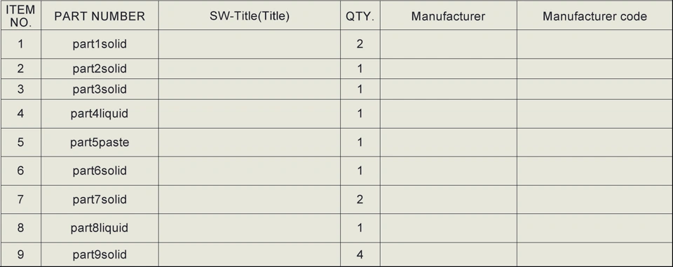

I've been wondering if there's a way to change the base unit of a single model. By default, it's "piece", but I've come across situations where it would be good if the quantity and unit were something other than even numbers and piece counts. Below are a few images to illustrate what I mean.

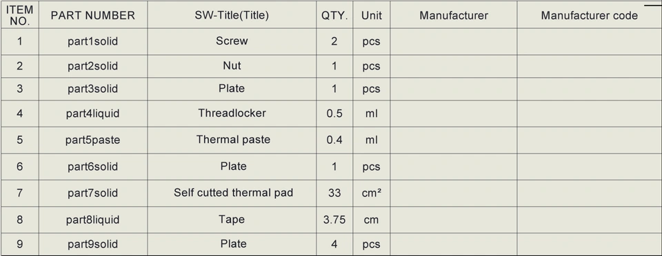

Liquid ones are not really necessary because they are difficult to model in mechanics, but for example that area and length. Let's imagine that the assembly would include a 50x50mm piece of heating mat. I don't want it to be just "1 pcs" in the drawing BOM, I would like it to be 25cm². Is there a way to change that default quantity and unit? I know you can define the unit in parts Custom Properties but how about the quantity?
From this:
To this:
