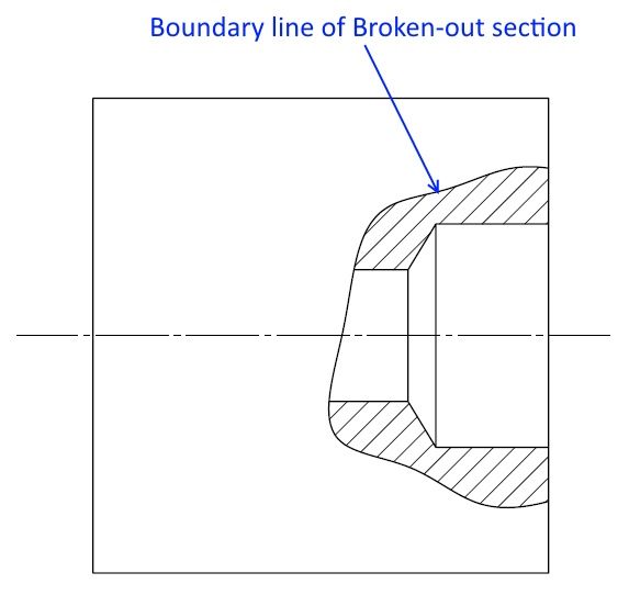

Is there a way to change the default line font for the boundary lines of a broken-out section in a view of a drawing (slddrw)? I'm using SW 2018 SP4.0. It appears to be using the Line Font of the "Visible Edges" right now (Options -> Document Properties ->Line Font). I was hoping it would use the "Break Lines" Type of edge instead (Phantom, Thick). This seems more logical to me.
I know a work around is to manually select all the broken-out section boundary edges one by one and manually change the line style and thickness every time, but I was hoping for something a little bit more automatic. Sometimes I use splines as a boundary and it splits the lines into a lot of separate sections that I have to select one by one. Thanks.
