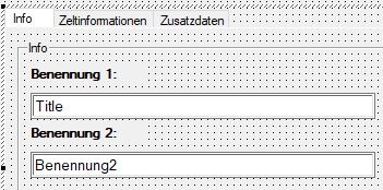

in my company they did change the ERP system and now i have to change the DataCard because the old ERP had "Name 1"(Benennung 1) and "Name 2"(Benennung 2) and the new ERP has only "Name".
Old DataCard:
New DataCard:
I want now to combine those 2 variables (Title and Benennung2) to make 1 "Name" variable.
The DataCard needs to be changed that the old and the new files only have "Name" displayed.
Has someone a idea how to do this the best way?

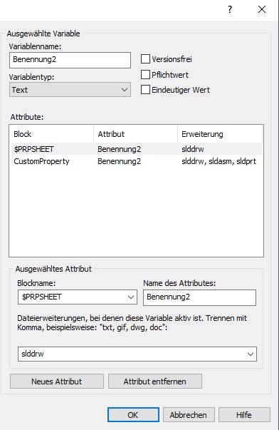

The variables are:
Every time i make a new variable the value is showing empty in the DataCard, i am working in a test vault as the administrator.
