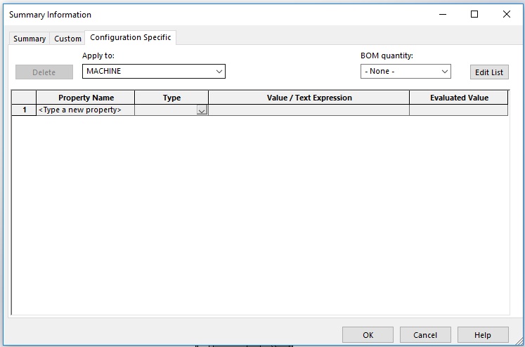

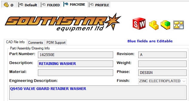

I'm trying to clean up some data in our PDM Professional Vault. On many files, there are configuration specific properties which are no longer needed.
These are causing some issues in PDM where in one example, STEP files are exported and the task cannot copy all the properties over correctly as the configuration specific properties differ from the custom properties.
In an attempt to remove them I checked the files out, ran #task to remove configuration specific properties but after checking in, the properties don't exist in the file but the datacard still contains the properties.
See below screenshots of the same files config specific properties vs the datacard.
This process doesn't seem to reliably work, has anyone gone through a similar process and could recommend how to make it work?
