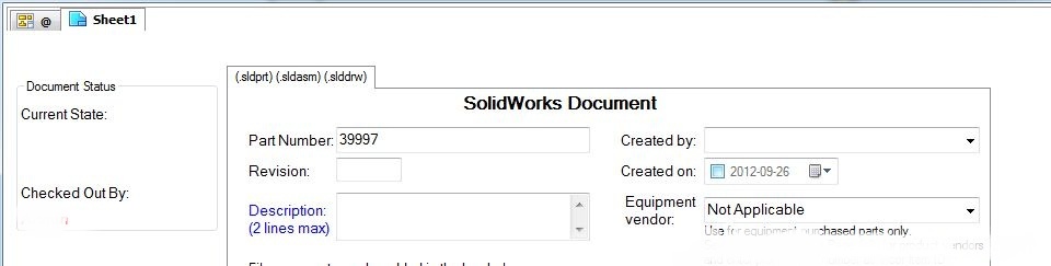

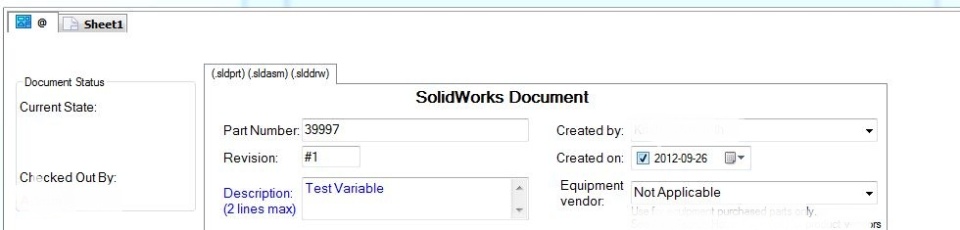

Data card variables not populating on Sheet 1 tab on drawing data card
In EPDM, our model and  drawing variables are set such that  when you create a drawing from a model the variables from the model are carried over to the drawing.
But it only, automatically populates "@" tab on the data card of the drawing. The sheet 1 Tab gets only the file name and other variables are empty.
The "update all configurations" is checked for each of these variables.
SW 2012 sp3 and EPDM 2012
