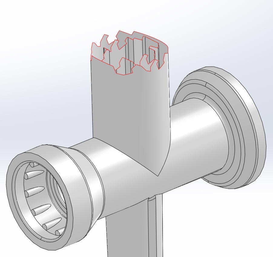

this pertains to the question where you are to correct some imported surface data and pull a mass from the resulting solid.
the question simply states to patch the surfaces, apply a material, and determine the mass.
simple enough right? well so I thought. My only guess is (rather than using a bisecting view to extrude the missing surface, trim and knit to solid) that they are looking for you to extrude the cylindrical profile and inner surfaces up to the highest tangent point of the cut-away section to make a flat top.

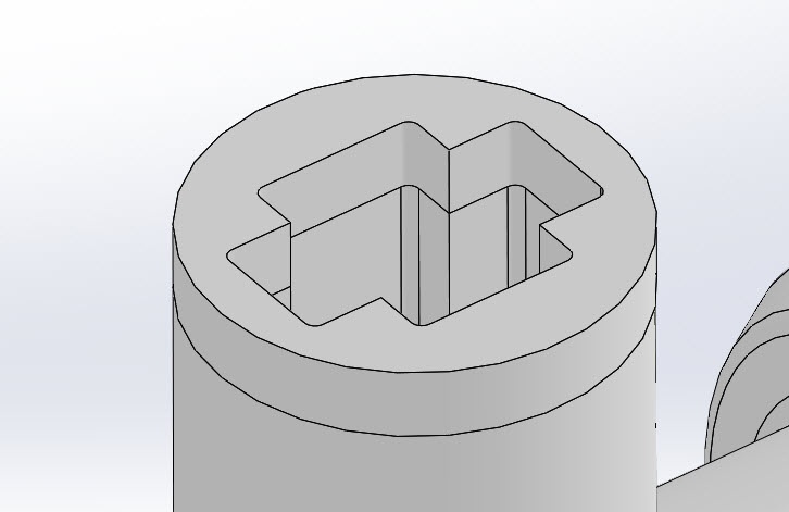

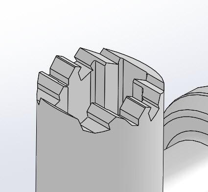

Here is what I initially came up with:
and here is what I think they may have actually wanted: (obviously this looks better, but again the question is pretty open-ended)
