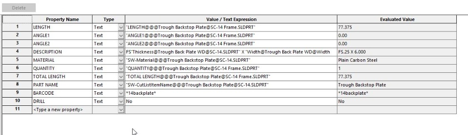

Hi all, new member here but with several years of using SW. I am running 2021 SP0, just upgraded today from 2020 SP3.
As you can see in the screenshots below, the Angle1 field is "0" but the actual angle is 55/35 degrees. It doesn't display the "Linked Values" checkbox in Cutlist Properties and won't let me change it manually. Neither will it allow me to manually link it to the angle dimension in the Cut-Extrude feature (such as "D1@Sketch11006@Main Frame.SLDPRT").
I can type the values in but it immediately reverts back as soon as I press Enter. It is doing this on two different flat bar bodies as well as one rect. tube body.
Any help would be greatly appreciated. TIA.
