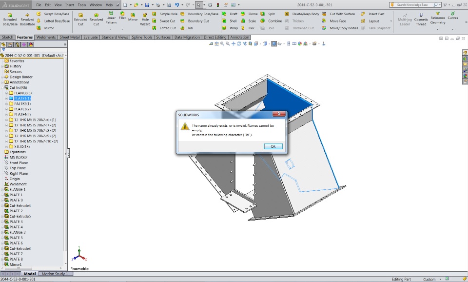

While working on weldment cut list and renaming any cut list item it shows the attached jpg error. I am changing the cutlist item name from Plate1 to Plate 1.

That is a correct error message as you already have a feature with that name. So try putting a - between Plate and 1 like Plate-1
