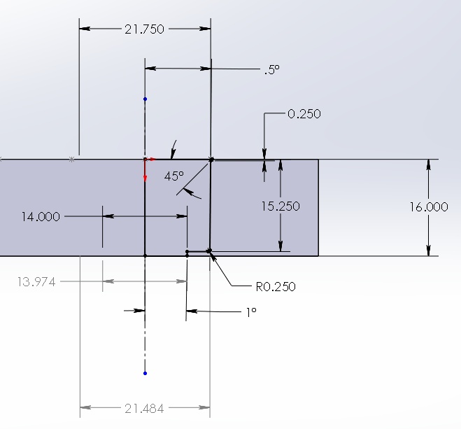

Haven't seen this mentioned, but do we have the ability to add new types to the hole wizard, to allow for molding or casting drafts?
This is what I came up with modifying a standard legacy counterbore sketches and afterwards realized I could have done it with a sketches and a sketch driven pattern. But would be neat if we could add customized profiles to the wizard as I am certain this would come in handy in certain industries
