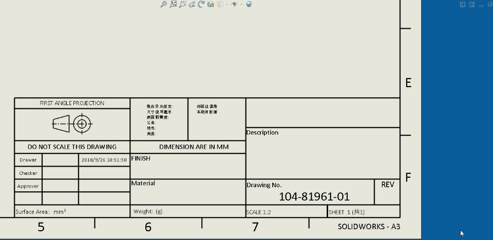

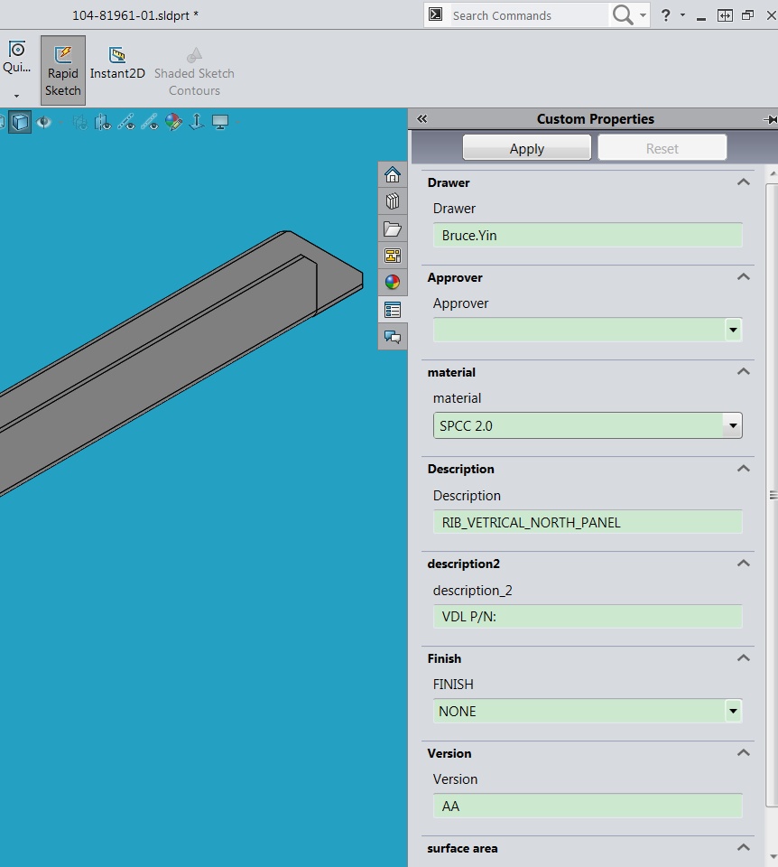

custom properties in my part

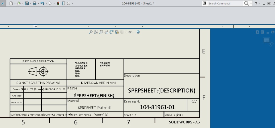

in sheet format,text has been linked to the property
But, nothing linked to the property,except drawing no&lasted save date
if i made drawing from the same part with my A2/A1  sheet format,it works well.
so i infer that there is something wrong in my A3 sheet format,but i dodn't know where.
