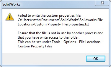

To combat this, I have set the text file to "read only".  This does effectively prevent SW from over-writing my properties.  However now, every time I go to the summary information tab, or switch between the custom and configuration specific tabs, I get a warning that SW could not write to this file.
I don't want SW to write to this file.  And why would it need to anyway?!?
Has anyone ever seen this?  Is there a way to prevent SW from trying to write to this file so that I can remove the "Read Only" attribute from this text file?  The warning it very annoying.  Plus, I can no longer use the Edit List button from the Summary Information window while it is read only either.
