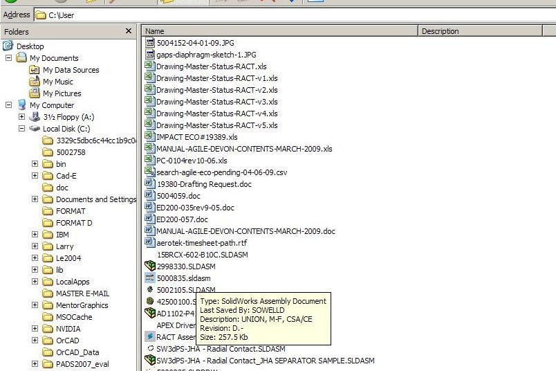

In SolidWorks, I assign a Description custom property. Then inWindows Explorer (Vista 64) I right click on the top row where itsays Name, Date, Type, etc, and click the More, then scroll down toDescription and put the check next to it. Description shows up inthe header row, and I reorder it next to the Name column. Theproblem is that the Description column is completely blank.
The files have descriptions, and Windows knows it. If I put mycursor over the name of the file (Detail view), the little cloudshows Type, Last saved, Description, Size. The Description value inthe cloud balloon is correct, but in the column it doesn't show atall.
