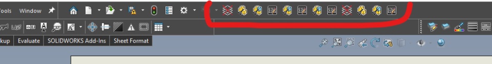

Recently running into this issue.
I have created 4 Macros and then assigned them to "New Macro Buttons" and applied some custom bmp icons.
Macros and their icons are managed in the vault (PDMPro 2020 SP2.0).
I Opened the system one day and the icons had just duplicated.
I though it was a glitch so, I removed them completely, restarted SW, then added all 4 again from scratch.
After restarting SW again they had triplicated
Cannot seem to get rid of them and have a single button for each macro
once you try and remove one of them the rest of the buttons "deactivate" as in they cease to be clickable and the link to the macro location disappears, as if all copies of the same button were "associated"
Video attached for clarification
Anybody have any idea what's happening? or maybe know how to "clear" solidworks' memory of those buttons so it doesn't triplicate them?
Driving me crazy

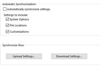

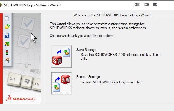

Tried re-importing settings from copy/setting wizard = No difference
Tried re-downloading synchronized settings = no difference
