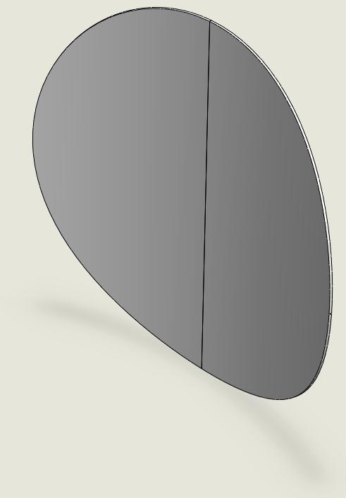

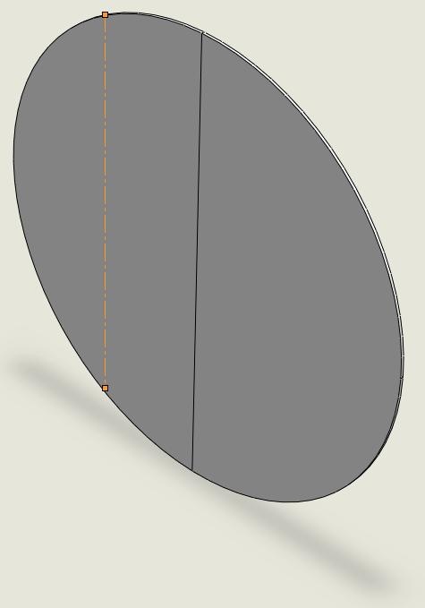

I have been attempting to make a curved sheet metal circularpart...not working. Any suggestions would be helpful. The closest Ican get is to make an accurate half, then mirror the part, createassembly but when flattened falls apart.
Sheet Metal Part: Diameter 22" x 0.1345 (10GA.) thick.
Part will be rolled/curved on a 48.1875" cylinder.
So basically it will look like a Pringles potato chip.
Edit: Got it to work in an assembly but there has to be a cleanerway? I will have to get it to work on a conical face too.
SolidworksSheet Metal
