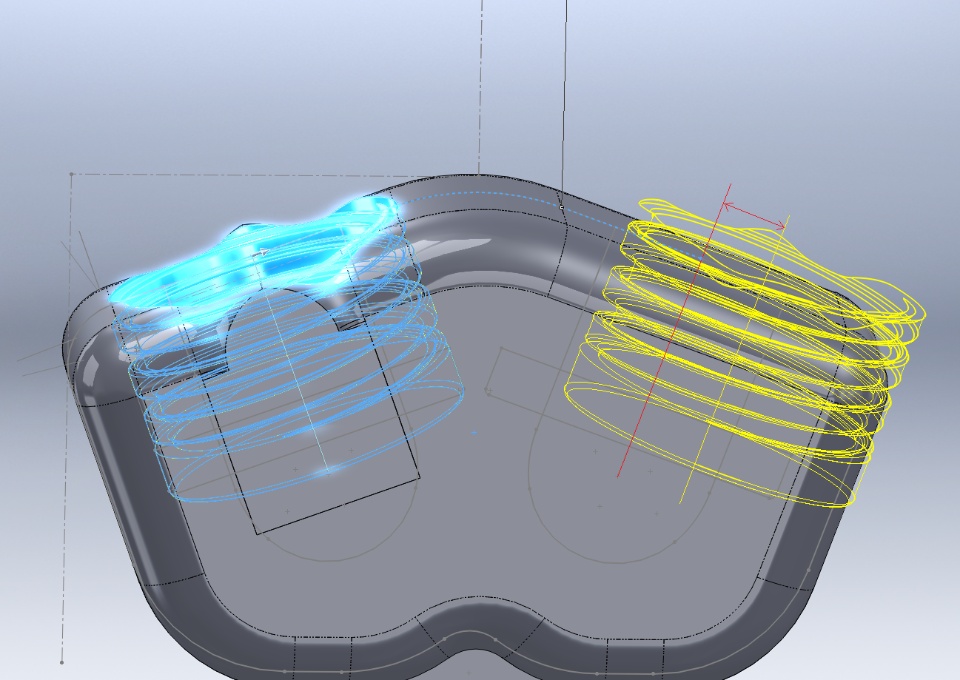

I dont use "curve driven pattern" frequently but I thought it might be a good fit for this application, however I'm having trouble getting it to position the duplicate features the way I want.  I am looking for advice from someone more familiar with this tool to help get the desired result.
In the image below, the hole I am trying to copy should be identical to the first, but with the hole axis mirrored about center of the part (this is my front plane).
For clarity in explaining what I need, I've sketched the hole axes on the image below.
The blue axis is the axis of the original hole.
The yellow axis is where "curve driven pattern" is trying to place the duplicate.
The red axis is where it needs to be.

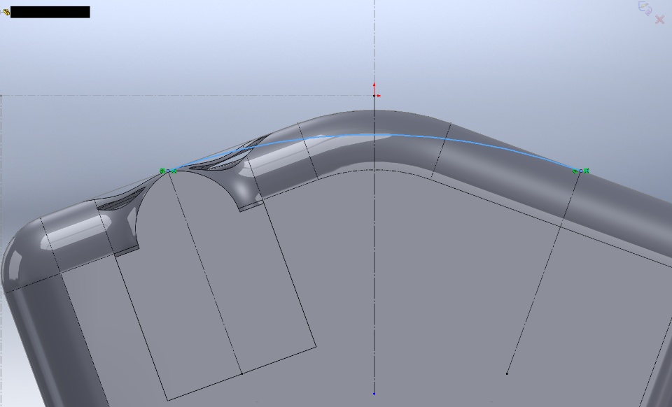

My curve goes from center to center of each hole.
To establish my curve, I drew an intersect line with the top surfaces and the right plane (mid plane of the part) and I set the end points on my hole axes.
*Looking at the image below, you can see my curve as a dashed blue line.  The endpoints of the line intersect the blue axis and red axis.
Settings I'm using for curve driven pattern dialog are:
Direction: Picked my curve
Instances: 2
Equal spacing: ON (checked)
Curve method: Transform curve
Alignment method: Tangent to curve (this does seem to align the axis at the correct angle, just not in the correct position)
Solidworks 2013 X64 SP3.0

I even tried taking the exact same circle I used for the circular pattern and having the endpoints end at each axis/top face intersection point, and while it was very close, it was still off.  See attached screenshot 003.
If you look at attached screenshot 001, you can see the grey sketch below, that is where the duplicate feature should be aligned.
I drew red lines to highlight the relative distance and angle of the thread major related to the tangent edge of the outer perimeter radius. The part is symmetrical about its mid-plane, so these should be exactly the same on each side (which is what I get using circular pattern) but as you can see the curve driven pattern is off.

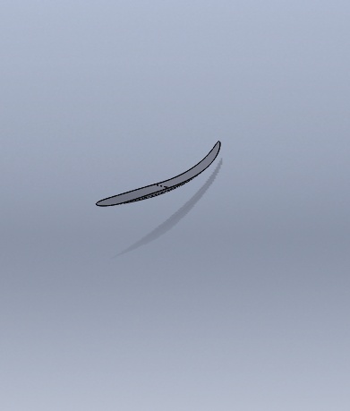

Another problem I found with the curve driven pattern is it never gives me the option to choose which bodies to keep, and as a result I end up with screenshot 002, which is obviously not the body I want.
