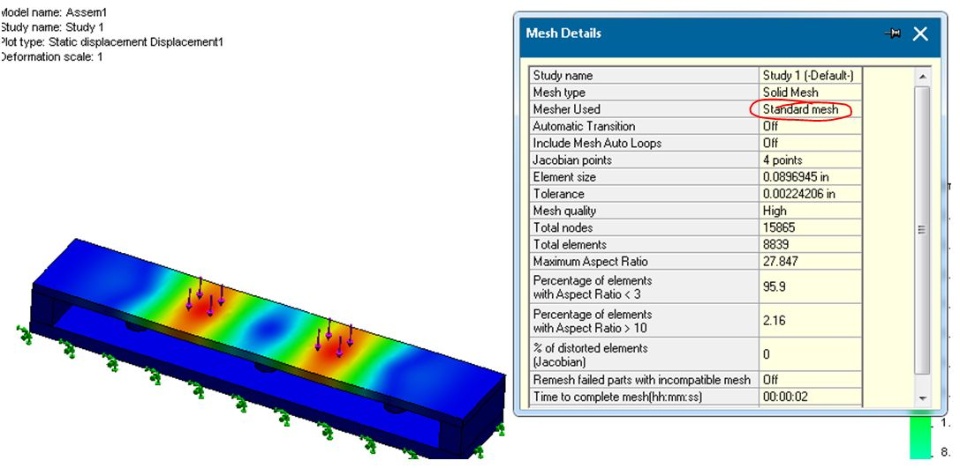

Curvature Based Mesh does not click well with non pentration contact set?
Hi
I am a self learner in Simulation, have been trying out ways I could use simulation to anticipate how objects are bent, stressed.
I used curvature based mesh quite oftenly because it can solve faster with more elements compared to standard based mesh.
However I just could not get curvature based mesh to work with a contact set of non penetration. But once I switch to standard based mesh, eveything seems working.
I need to ask fellow users of Simulation, is this a bug or something I have not done correctly?
I am using SW2010 Simulation
Note that the 3 buttons are not bonded to the upper flat bar, it has very small gap. I used contact set non penetration between the surface of each button and the face of the flat bar facing down.
Then my fellow engineer told me if I were to make curvature mesh works with non- penetration, I got to reduce the surface of the contact set of the flat bar by creating split lines. So I did a 3 circular splitsfor each button on the flat bar. To my surprise it worked!!
So my next question is, why it worked and how do I define small area? Is there other way I could have make it work with non-penetration contact set?
I would be delighted to hear any kind advice.
