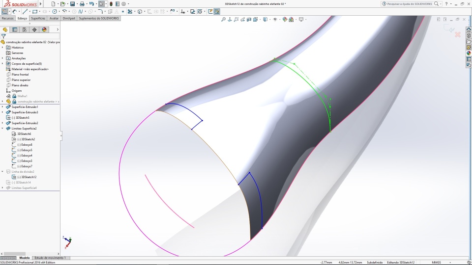

Another example of 3D spline for utility that can not currently be used:

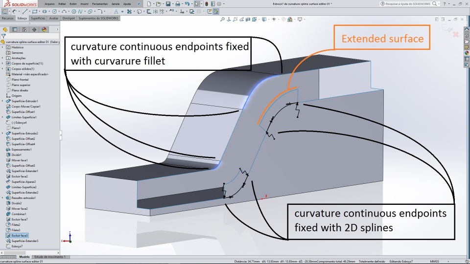

The intersections or boundary between surfaces shown in the picture below are in tangency condition to be able to build a curvature surface must first be placed endpoints in continuous curvature ::
To do this, I replace the fillets to fillets curvature continuous, extended the surfaces and made a 2D spline curvature condition and trimmed the surface, the result was a very smooth surface curvature continuous using bondary surface.
But when I try to do the same thing but in a situation of curved surface is not possible to place the curvature relations using surface splines:
i really do not understand why this rhappens.

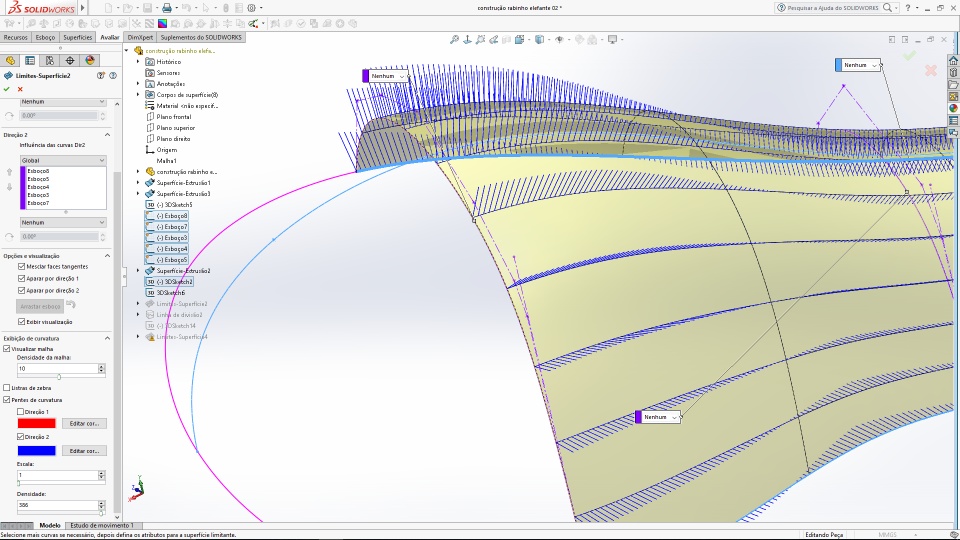

I need to do a animal tail, this is the situation (made in SW2016):
I did the face split/lines using 3d splines on surface (the blue lines)

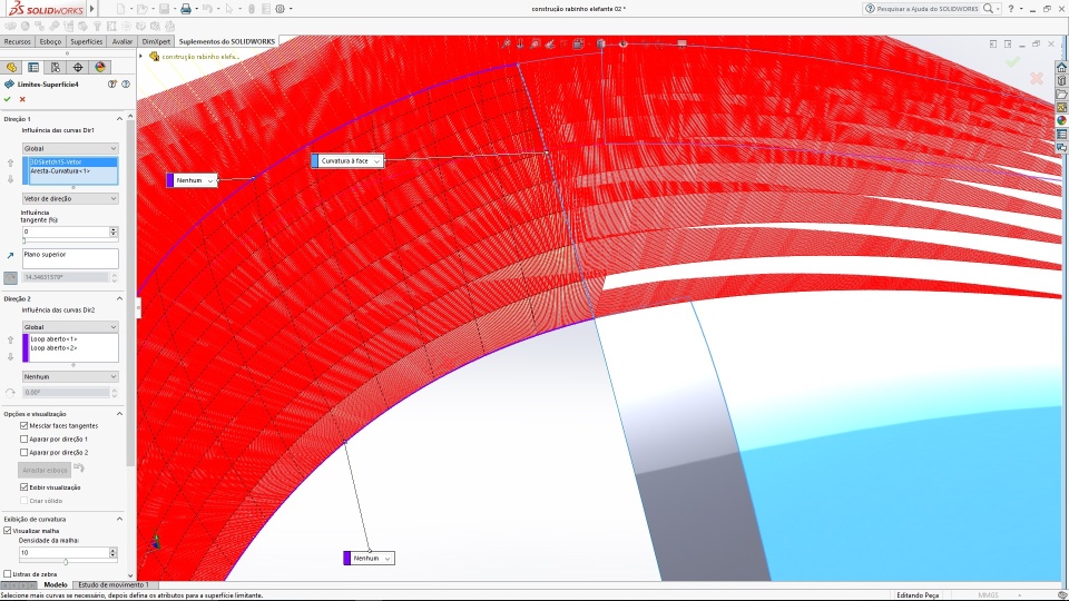

I am having a problem with curvature surface with spline continuous, for some reason the curvatures is inverting (inflection) next to the final point:
So if i set to tangence its look fine, (like in solidworks2008):
I thought that was a possibility to the main surface has some curvature problem but don't have any inverted curvature:
I know that have a lot others ways to fix that, for eg, add more two controls lines and make the splines curvature from that and drawing it in 2D planes, but i dont undestand
why this happens with 3D splines.

UPDATE 10/12/16 ( 02 tail curvature... file )
I uploaded a new model, I tried replace main surface using loft surface, and I made
the curvature continuous splines using 2d planes.(image above with zebra stripes)
but I still having problem with spline 3D curvature (red line).
i tried just set curvature continuous (selecting spline/plane/endline) without a line split in surface, but with this method i don't have
a really good control for the direction tha spline gona out from surface, but nether this method i have good curvature out, see image below:

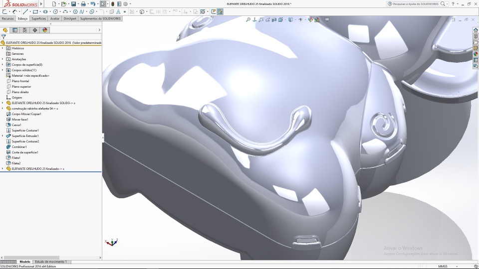

i know that i can close my eyes and accept this because my job is with toys, not with automobilistic things, (i had done the tail):
but i thought that I gonna have big improviments for surface and anylises tools upgrading my SW2008, because it was almost 10 years of development, and i do not understand why they didn't improve the software to do better continuous surfaces (maybe i am wrong or maybe SW team don't want improves this for some reason,).
