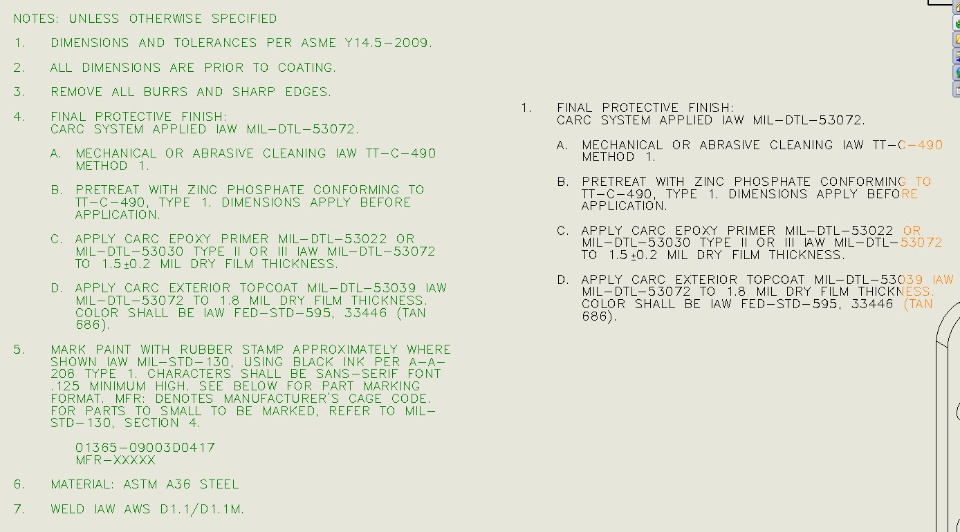

So, I have been scouring the forums for a macro that will help me update a lot of drawings with a single click of my mouse. The problem is I have not been able to find one that will do what I need.
I need one that will replace a string of text in a note in the fashion that "Ctrl+F" works and not "Find and Replace Annotation". I have tried both ways manually and the "Find and Repalce Annotation" removes my bullet and does not change the text. I will be combining the code with some code for changing information in the revision table. I will also be wanting to update a note that is on the format of the sheet as well.
I have attached a screenshot of the text that is in the old note (left) and needs to be replaced with the new portion of the note (right).
