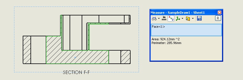

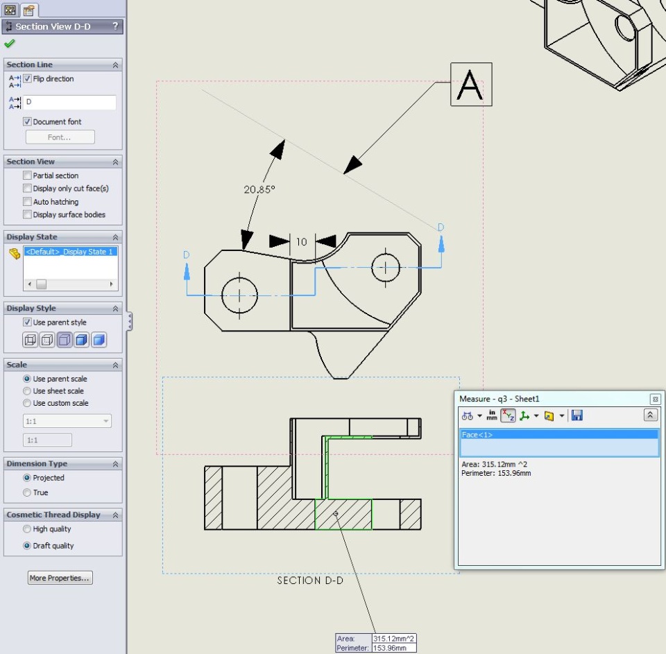

I was checking out the sample exam for the new CSWP-Drawings cert, and I whipped through it only to find I missed a question.
What do I have wrong on question 3 here?  I'm getting 153.96mm and the answer at the end of the PDF says it should be 175.96mm.  If you compare to the images in the Sample Exam PDF, you can see there are some lines on theirs that I don't have, and their section view doesn't even line up with the front view (they're not even the same size?!).  Can someone hit me up side the head and show me where I went wrong?
I got question 1 & 2 correct so I can assume my "Front View" is positioned correctly.
Image attached.  Thoughts?
