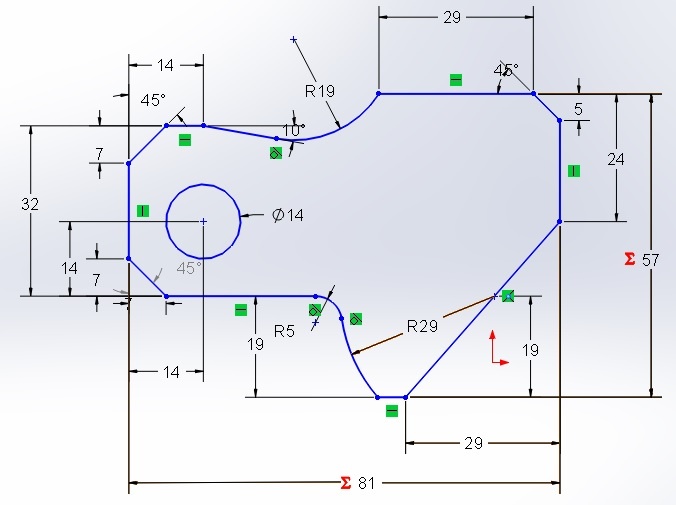

I am relatively new to Solidworks and want to take the CSWA test soon, but I'm having an issue with question3!
My mass is 958.34 grams and needs to be 939.54 grams.
My A,B, and C equations are correct, so I'm not sure where the issue is.

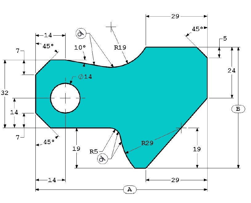

Below is my sketch and then the sample exam's image.
