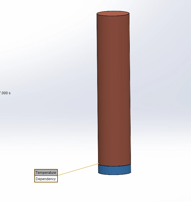

I’ve built a basic assembly where:
  • The bottom part represents a simplified model of the cryocooler’s cold tip.
  • The upper part is a copper object that needs to be cooled.

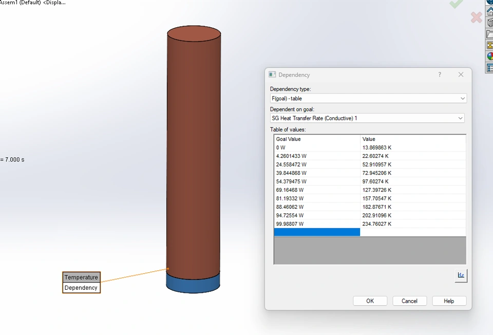

The cold tip temperature depends on the thermal interaction with the middle surface of the assembly. I’ve defined this dependency using a table (see below).

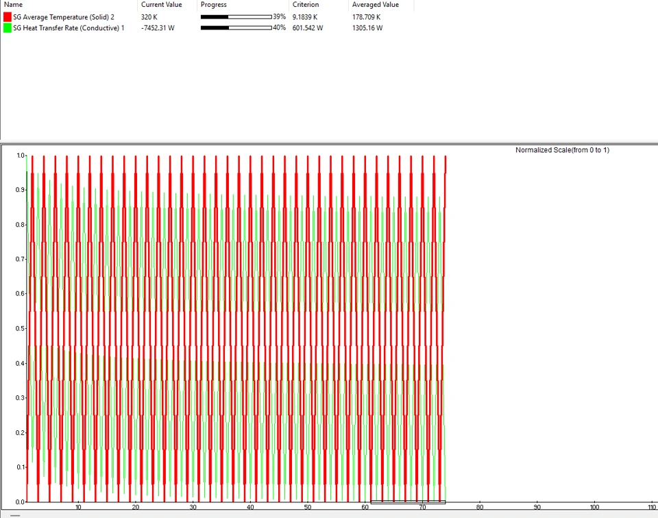

When I run the simulation, instead of observing a gradual temperature decrease at the cold tip over time, I see oscillations in both temperature and heat flow rate (screenshot attached). This doesn’t seem physically correct—I’d expect a smooth transient response.
Has anyone encountered similar issues? Any suggestions on how to stabilize the simulation or adjust the model settings?

  1. Dependency table (heat load vs. temperature)
  2. Graph showing temperature/heat flow oscillations

Simplified model cryocooler(cold tip is bottom part)
Table which i made for temperature dependency
Oscilations of temperature
