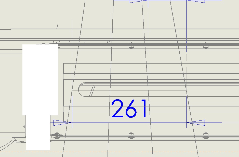

I'm running into performance and display issues when this geometry is shown in my drawings, when the view is cropped.

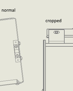

First issue is after cropping the view the sketch geometry is shown thicker on my screen for no reason I understand.
Not cropped:
Cropped:
It is more obvious on my screen where the views are side by side...

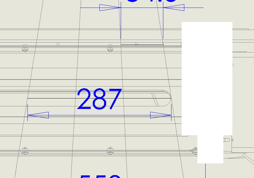

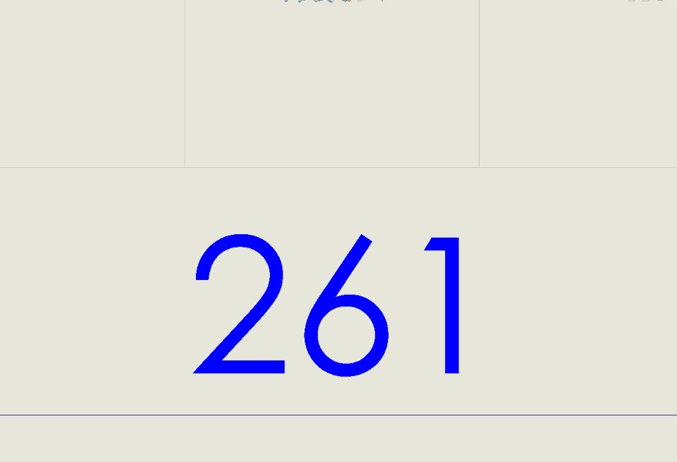

Next issue is beyond a certain zoom level the sketch geometry vanishes, which is causing me difficulty. The less complex sketches remain visible.
There is no such display issue when the view is not cropped.
