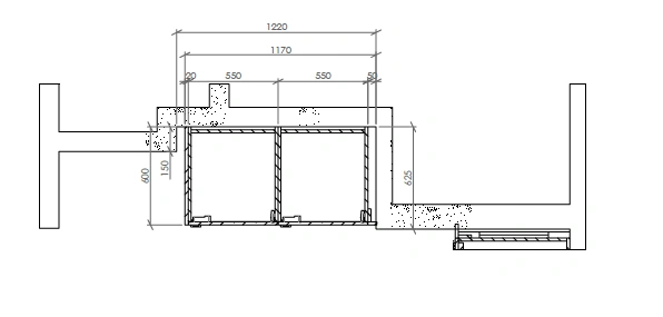

When we crop a section view, 90% of the time some of the hatches (expecially those with dots) fail as shown below.
In order to comply with our design style, we need to show materials such as walls and stone with dotted patterns like AEC sand.
Can anyone suggest a solution or recommend a better workaround than our VAR?
(Copy the view, create a detail view, rename the detail to pretend it's a cropped section, hide the section off-sheet)
