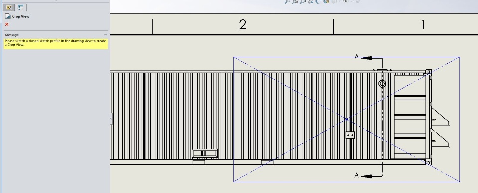

I'm having a heck of a time with trying to create crop views.   I sketch a profile (circle or rectangle), making sure that the correct view is active and attached to the sketch.
Then I hit Crop View...and it asks me to sketch a profile.
It doesn't seem to recognize the existing profile.  If I click over to the sketch tab and make another profile, it just creates another profile and forgets that I was trying to crop.
If I do this three or four times, it does work and I can crop the view, then I have to delete the sketches that didn't crop.
I'm not sure if I'm doing it incorrectly or if it's a bug.
*Edit*
Thanks everyone, I seem to have it figured out.   It does seem to work most of the time, if I create the sketch then immediately go to crop view (don't click anywhere which deselects the sketch).   Getting it to work if there was a break in the workflow, requires that you select both the view and the sketch before hitting crop view.
