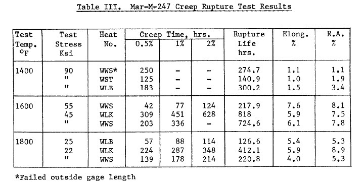

I am trying to determine the constants described in the help file to model creep life with simulation. Does anyone have any experience doing this? So far, I haven't been able to find a valid solution using a system of four equations. I found the link showing an example problem where C2 is assumed to be 1 (http://www.motovated.co.nz/newsletter/aug13/FAQID__x394.pdf); the only problem with this is they say it is usually safe to assume C2 = 1, but don't say when it is not. Below is an image of the creep life data we're using to determine the constants. We will be using Heat No. WWS.
Any help would be greatly appreciated.

Any value less than 1 for C2 results in a smaller amount of creep strain, so it's a conservative assumptions to set C2 = 1. To calculate the values of C0 and C1 for Heat No. WWS, you'll need to use either the 1600 deg F or 1800 deg F data sample. This will also assume that you're analysis is done at a constant elevated temperature.
For 1600 deg F you have two equations:
  1. 0.005 =[C0*(55 ksi)^C1]*(42 hr)
  2. 0.01 =[C0*(55 ksi)^C1]*(77 hr)
Here you have two equations and two unknows, so a unique solution exists.
For 1800 deg F you have two equations:
  1. 0.005 =[C0*(22 ksi)^C1]*(139 hr)
  2. 0.01 =[C0*(22 ksi)^C1]*(178 hr)
Make sure to use consistant units when calculating your constants.

Jared, is there any additional information that came about from the developers out of this project?
If we want to leave C2 as an unknow constant, then we can still solve for C0, C1, and C2.
For 1600 def F at Heat No. WWS:
  1. 0.005 =[C0*(55 ksi)^C1]*[(42 hr)^C2]
  2. 0.01 =[C0*(55 ksi)^C1]*[(77 hr)^C2]
  3. 0.02 =[C0*(55 ksi)^C1]*[(124 hr)^C2]
Here you have three equations and three unknows, so a unique solution exists.
For 1800 def F at Heat No. WWS:
  1. 0.005 =[C0*(22 ksi)^C1]*[(139 hr)^C2]
  2. 0.01 =[C0*(22 ksi)^C1]*[(178 hr)^C2]
  3. 0.02 =[C0*(22 ksi)^C1]*[(214 hr)^C2]

shaun, you are totally correct
in the case of this project we actually had creep curves that needed to be converted so your method could have worked but the curve would be skewed based on what points were chosen
we used the guess and check method to determine constants that matched the curve as much as possible
we also need to address that the length of the creep time far exceeded that of the curves and had to come up with a reasonable extrapolation method and also make sure our constants made a curve that matched reasonably
i should also second your comment about making sure the units are consistent and also making sure they are in the unit system expected by the software. this is well documented in the solidworks kb.

Thank you this is very good information. It looks like the calculation is fairly straight forward if the part is at a constant temperature, unfortunately the part I'm analyzing is not so I will need a CT value. Judging by what you both have said it doesn't sound like I have enough data, is there any way of determining all four constants with the data shown above?

your constants are going ot characterize 2 curves
from there you should be able to build a more general curve that defines any temperature to a certain extent

Jared, I think I understand what you're saying to do. You mentioned in an above comment that you had to find a reasonable extrapolation method to make sure the constants matched, would you mind elaborating on how exactly you ended up doing that? The part I'm analyzing must have a creep life of 9,600 hours so I will definitely need to look into that.

BN is a power curve so we used that for extrapolation
but we also had to use a linear interpolation in one case because we were at the very end of the curve and were fitting the curve to multiple other curves
my suggestion would be to start digging for more material properties for that material, i don't think you have enough information to characterize the situation you're running into
