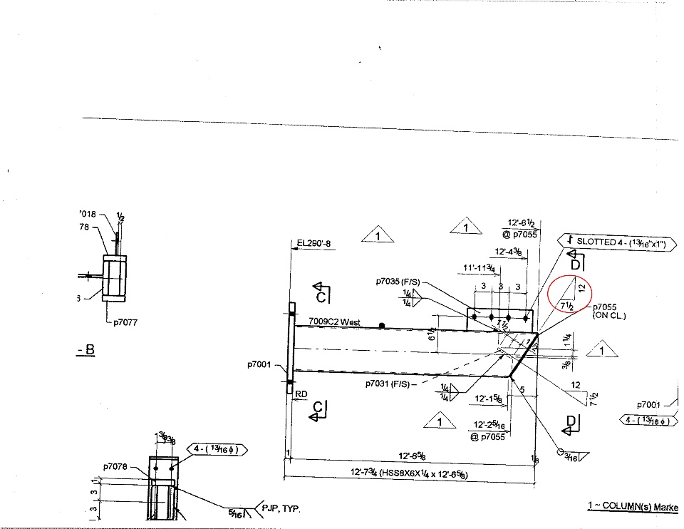

Good morning all,
Just a quick question regarding the availability of a "bevel/rise&run" symbol in SW.  I work with structural steel drawings where most of the time an angle is shown at rise / run instead of the typical angular value.  See attached with the red circle.  I did some searching online but didn't see anything quite relevant to what I was looking for.  I doubt SW has this capability instead of the standard angular dimension value but thought I'd ask.  Assuming I would need to make a block and put the values in manually where the slope is required to be shown in this format.  Thanks in advance.
