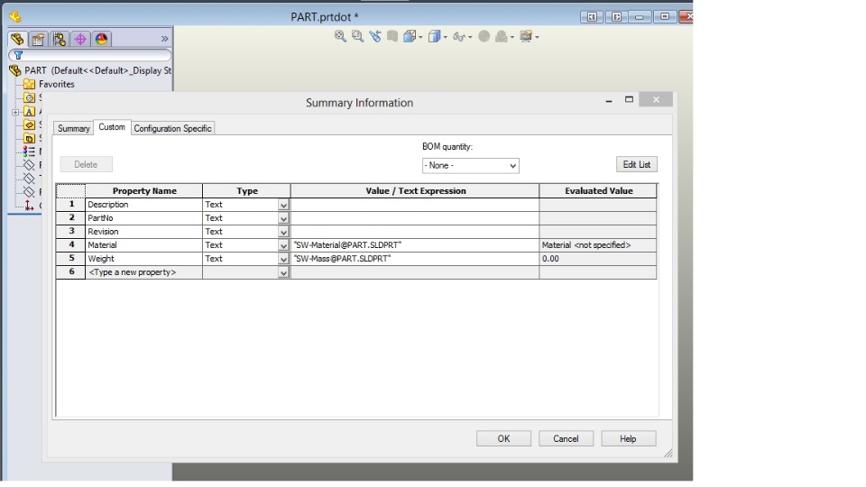

Creating part and drawing templates, trying to insert info automatically from part file
Alright, for some reason I can't seem to get this set up correctly.  I've created a part template with a custom property for the part weight (see PART.prtdot.jpg attachment)

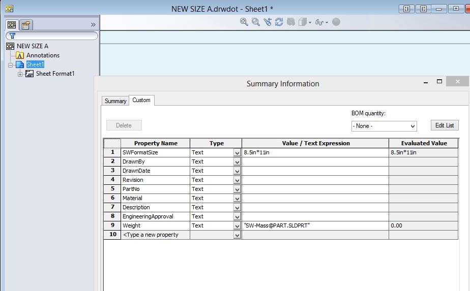

I have also created a drawing template which I want to have pull the part file weight into by setting up a text box on the edit sheet format layer with a link to the part file (see NEW SIZE A.JPG)  The evaluated value in the template form says 0.00 but when I use the template to create a new drawing from the part template I don't get the part weight I get the SW-Mass@PART.SLDPRT code.  PLEASE HELP!
