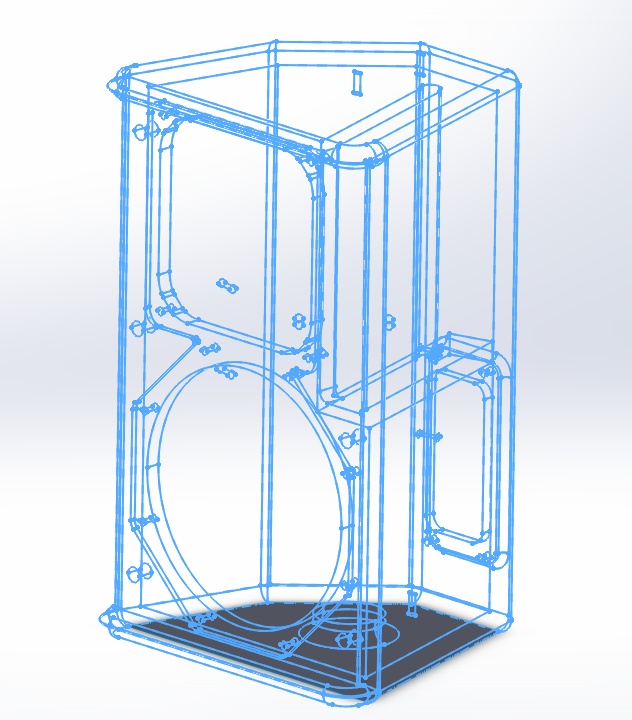

I am interested in strategies for creating a solid feature from an imported 3D sketch.
I have imported a 3D sketch of a speaker box from ACad and would like to create a solid. The sketch has many fillets and therefore many surfaces which makes for a long process if trying to use a boundary surface to construct the entire box.
I have also tried selecting and copying the profile of the pieces that make up the speaker box but SW won't allow me to select and copy individual splines.
If anyone has a better approach I would be very grateful.
