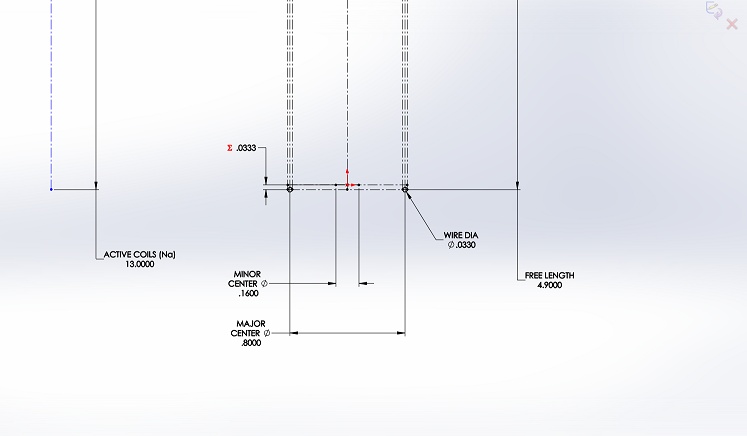

First I create my control based sketch, this defines my variables.

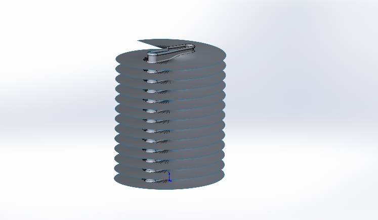

This sketch defines the major and minor, thus I create a surface extrude based on the free length:
Finally I create a helix surface based on the free length to define the intersection of 2 surfaces:

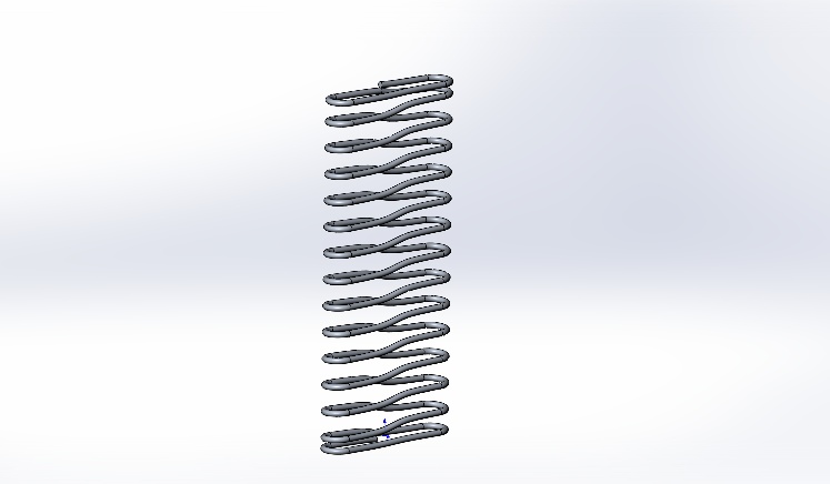

I then create the 3D intersection sketch between the two surfaces and I am left with:
But the pitch is not correct due to using a circular helix, spiraled around a 'oval' slot. Any suggestions would be greatly appreciated. SAMPLE file attached
