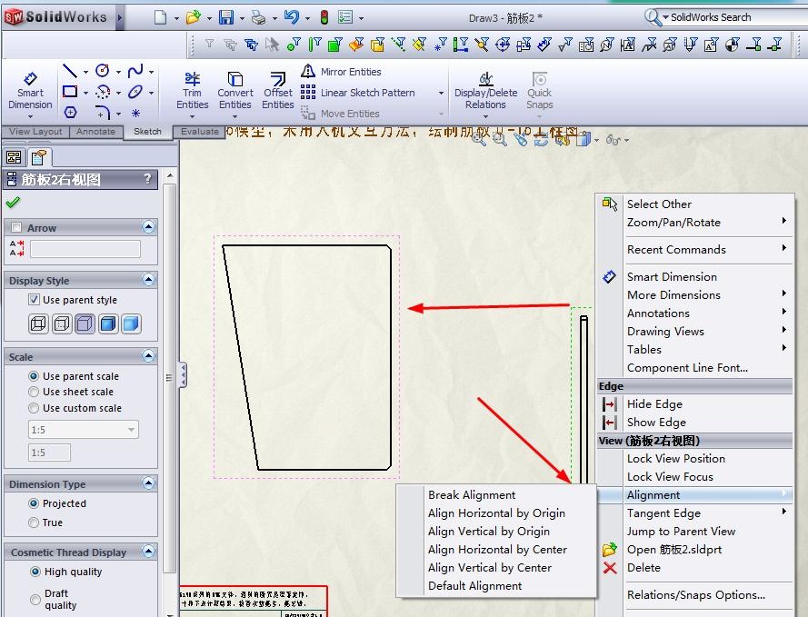

CreateUnfoldedViewAt3→Alignment is error?
Question
                        Set SwView = SwDraw.CreateDrawViewFromModelView3(ModelName, ViewName, Xx, Yy, 0)
                        Tmp = SwModel.Extension.SelectByID2(SwView.Name, "DRAWINGVIEW", 0, 0, 0, False, 0, Nothing, 0)
                        Set SwView = SwDraw.CreateUnfoldedViewAt3(Xx, Yy, 0, False)
result is Alignment is error.
