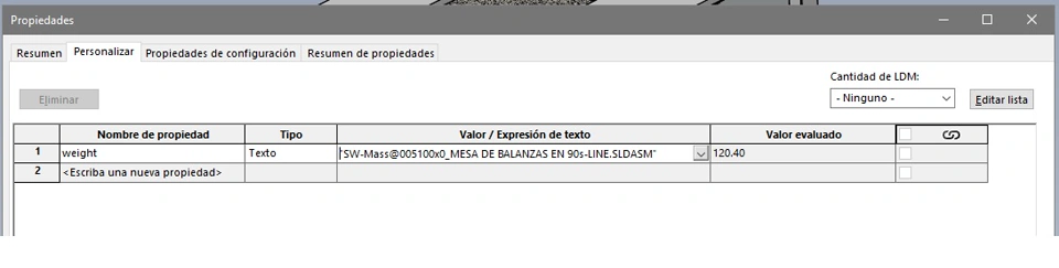

I'm trying to create a VBA macro in SolidWorks to automatically add a custom property called "weight" to my documents (parts and/or assemblies). This property should be linked to the SolidWorks mass property (SW-Mass) so that its value updates automatically.
I've been debugging this issue for a while, and despite simplifying the code as much as possible and checking references, I still get the same error on a specific line. I need your help to understand what could be happening.
The idea is that when I run the macro, SolidWorks will:
Find the name of the active document (e.g., MyPart.SLDPRT or MyAssembly.SLDASM).
Create or update a custom property called "weight."
Property Name: weight
Type: Text
Value/Text Expression: 'SW-Mass@MyDocument.SLDxxx' (with single quotes)
Evaluated Value: (e.g.) 5.34 kg
SolidWorks 2023 SP5
VBA 7.1
SO: Windows 10
Thanks scriptSolidWorks

You do not need to find the name, this is automatic.  This macro works on Parts and Assemblies.
'by J. R. Sitek
'10-JAN-2023
'This macro adds/sets custom properties
Option Explicit
Sub Main()
Dim swApplication As SldWorks.SldWorks
Dim swModel As ModelDoc2
Dim swFileSaveErrors As swFileSaveError_e
Dim swFileSaveWarnings As swFileSaveWarning_e
Dim vbMaterial As String
Dim vbWeight As String
Set swApplication = Application.SldWorks
Set swModel = swApplication.ActiveDoc
'Add Custom Properties
If swModel.GetType = swDocPART Then
   vbMaterial = Chr(34) & "SW-Material@PART.SLDPRT" & Chr(34)
   vbWeight = Chr(34) & "SW-Mass@PART.SLDPRT" & Chr(34)
   swModel.Extension.CustomPropertyManager("").Add3 "MATERIAL", swCustomInfoText, vbMaterial, swCustomPropertyDeleteAndAdd
   swModel.Extension.CustomPropertyManager("").Add3 "WEIGHT", swCustomInfoText, vbWeight, swCustomPropertyDeleteAndAdd
End If
If swModel.GetType = swDocASSEMBLY Then
   vbWeight = Chr(34) & "SW-Mass@ASM.SLDASM" & Chr(34)
End If
'Save document
swModel.Save3 swSaveAsOptions_Silent, swFileSaveErrors, swFileSaveWarnings
End Sub

In principle, you do not need a macro for this. Simply change your template file (e.g. the *.PRTDOT) and add the properties there
comment imagecomment image
