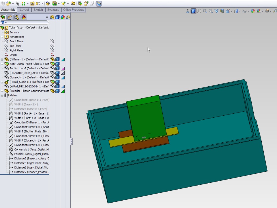

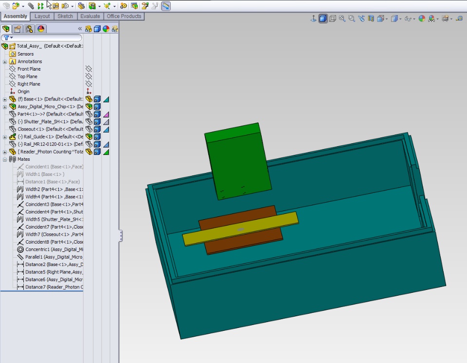

I'm trying to create a configuration similar to the attachment. One config will show the green part touching the yellow part and another one with the green part moved up 1" from the green part. If you look in the mates in the design tree Distance 7 should control this but when I adjust the dimension both configurations shows the part in the same location.
The way I did it is under configuration manager, I added a new configuration and using mate distance 7, I made this 1" distance but when I switched back to the default configuration (parts touching) the part is still 1" away as in the new configuration.
