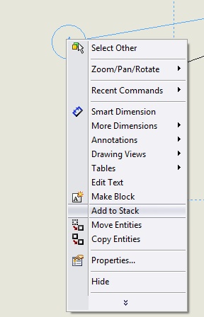

The part I'm having problems with is step 3. I've tried pre-selecting the BOMBalloon when calling InsertStackedBalloon2 but it doesn't work. I know in the GUI, one of the RMB menu options on single BOMBalloons is "add to stack". I suspect there is some similar functionality for transforming individual BOMBalloons into balloon stacks but I can't find it.
Is anyone aware of a method of creating a BalloonStack from a single BOMBalloon?.
