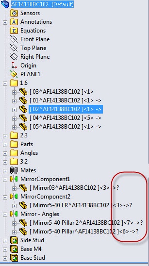

First of all I tried pack and go feature. The references in virtual parts were fine but mirrored parts showed
broken references.

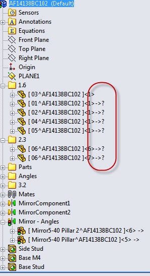

Then I tried rename from Solidworks explorer.
This time the mirrord parts refrences were fine, but the virtual parts references were broken.
