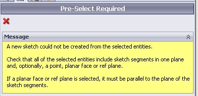

2012 - I have a top down assembly and am looking at a section view (with ends capped selected) using the Front Plane. If I select the cut surface, it shows a highlighted perimeter around the cut body. I need to convert it to a sketch to work with and also to have the sketch update parametricly if the body changes in the feature tree above it. How can this be done? I have seen postings mention tools>sketch tools> intersectoin curve but this does not seem to work. Select Entities box - as I try to select items, it highlights the exterior edges of the body beyond the section plane instead of the perimeter line generated at the section plane. I have also tried the Create Sketch From Selections sketch command. It requires a preselect so I preselect the face of the body at the section plane and the perimeter I want highlights. This gives me the following error.
this has got to be one of the most basic tasks to do in solidworks so I must be doing something wrong. I followed this exactly as stated below and got the error message shown above. Any help would be greatly appriciated.
