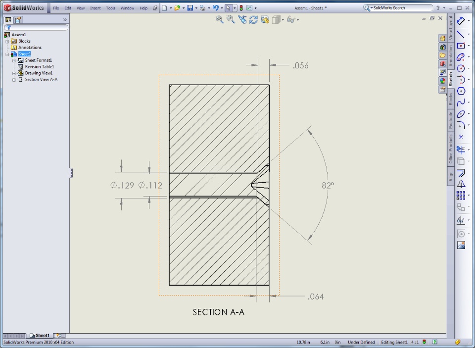

I have trouble on the height of the counter sink hole.
the section view is the #4 counter sink hole that I created on SW 2011, the dimension 0.056 is shorter than the screw head.
for # 4 flat head screw head is .067"
is there anyway to fix it? not only the #4 counter sink hole has this issue, other size has the same issue, i.e. the hole depth is shaller than the screw head height
Since I use the counter sink more often with varity sizes. is there anyway to modify the data base?
