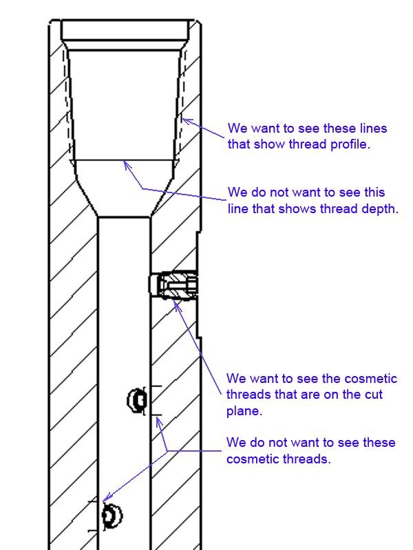

I used the hole wizard to create an NPT threaded hole on a cylindrical part.
I then used a helical pattern on the threaded holes.
When Im in the drawing view it shows all the cosmetic threads, on every hole, I only want to see the ones that are on the section.
If I hide one of them, it hides them all. Any idea how to get around this?
Also, is there any way to get rid of the line on the cosmetic thread depth? all we want to see is the cosmetic thread profile.
Thanks.
Added an image in case my explanation wasnt sufficient.
