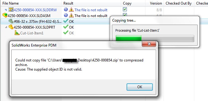

Copy Tree does not work with cut-list item

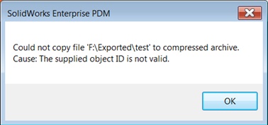

If we try to do a copy tree on a file with a cut-list and send it to an archive folder (zip), it will error out. "The supplied object ID is not valid"
Anyone else have this same issue?

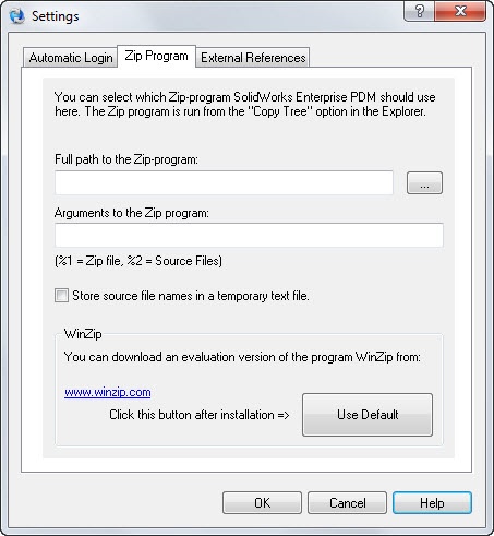

We are using EPDM 2012 sp4.0 with the default settings for "copy tree" under the user group settings. Also no changes to the default compression software (left blank). Everything else seems to work just fine.
