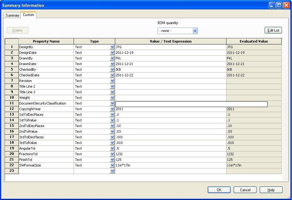

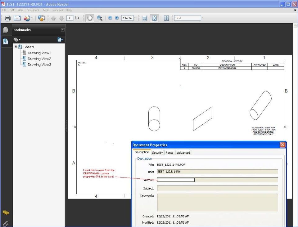

I have an issue that would really save us some time. I am using a macro to print solidworks drawings to pdf and add the revision number. ie: drawing TEST_122211.slddrw would print as TEST_122211-R0.pdf. What I would like now is to have custom properties in SW become properties in the PDF file properties. For example, the person who creates the drawing in SW adds their name to the DRAWN custom property and uses the macro to pdf print the file. When I open the pdf in adobe and go to File>Properties in the description tab it has text boxes for Title, Author, Subject, and Keywords. I'd like to have the Author text be pulled from the DRAWN custom property in Solidworks and other properties in the title and subject fields. Instead it pulls the computer name and calls that the author. We then open the drawing up in Adobe Pro and manually edit the file properties to be what we want. Not everyone who has solidworks has adobe pro so these files have to be transferred to the person with the adobe pro license. I'm attaching some sample screenshots of what I'm looking for.
