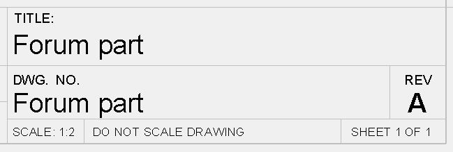

We produce parts, assemblies and drawings for fabricators and rely heavily on custom properties. We export each drawing out as a PDF in the format: PART-NO.REVISION-LETTER.PDF. For example: SW001.issueA.PDF. This is saved and renamed manually despite the revision letter being in the custom properties.

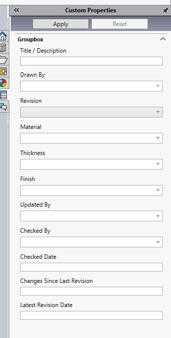

When producing a new drawing for the part, the revision letter correctly pulls through to the drawing, but not to the custom properties. See below:
One solution was to use a macro to pull through the custom properties from the part to populate the drawing. This appeared to partially work but only on fields that were text (not drop-down menus) and only on parts. I'd need something to pull through custom properties from both parts and assemblies. Also, to pull through ALL of the fields. I stumbled across the below macro which only some way does what I need:
