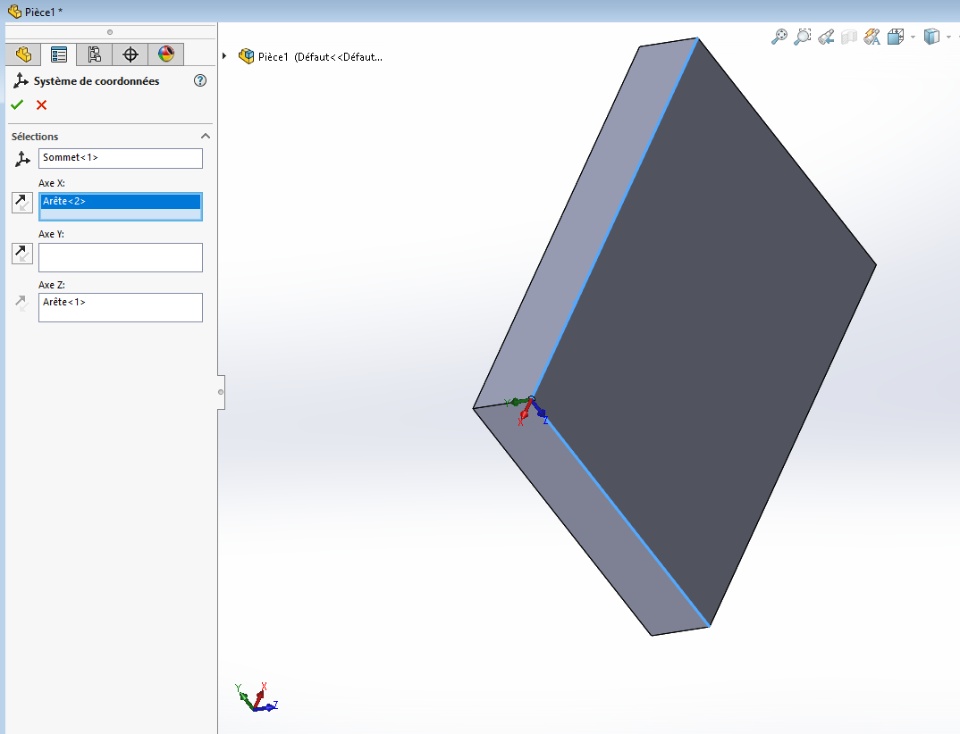

I have an issue when I create coordinates systems. I and several colleagues have struggled upon this for 2 days and we still can't figure it out :
When I create or edit the system, the Coordinates System PropertyManager open (see picture). I select an origin, a reference for X, Y and Z. The I save with the "validate" button :

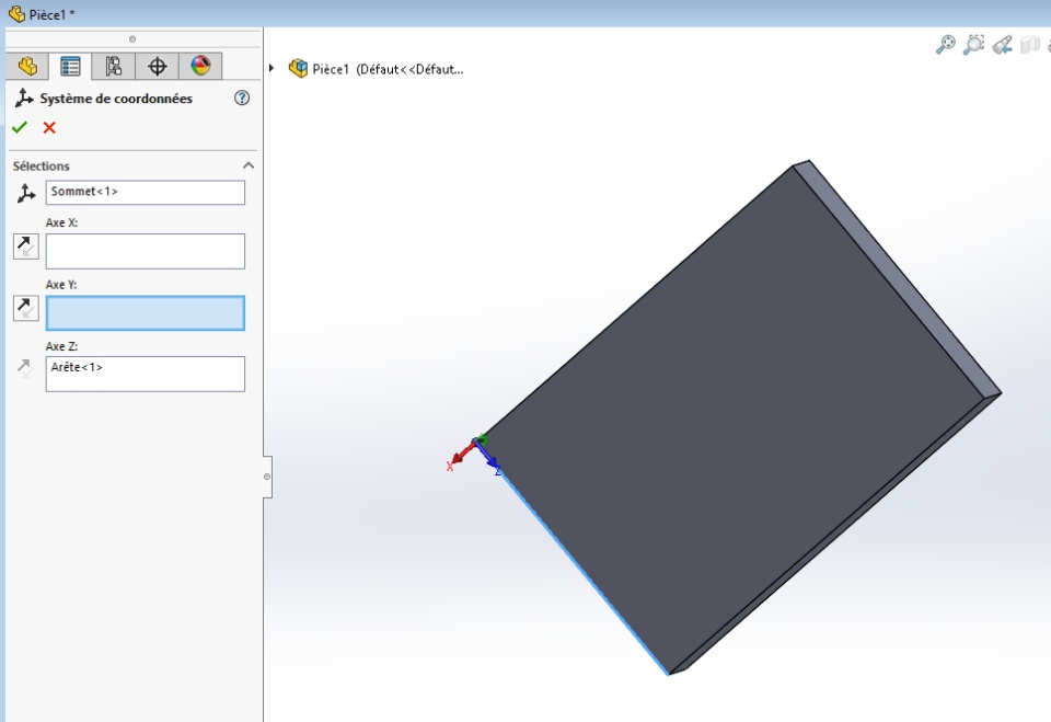

The problem is, if I edit this coordinate system again in the PropertyManager, the references that I setup the first time are not the same. Now there is a reference for Z and Y but the reference field for X is empty :
New coordinate system : I select on origin, a reference for X and Z, and I save.
When I reopen it, the reference for Z is still there, but the reference on X is empty and there is a reference on Y wich was generated by Solidworks !
Another try : I selected a reference for X and Z , and when I repoen it there is only the refernce for Z.
I did it again, and when I reopen itthe three fields are empty.
Sometimes, the coordinates system rotate when they "loose" one of the references.
I tried to use all kinds of references (axes, cylinders, points, sketches).
I tried to create the coordinates systems in the general assembly, in the subassemblies and it the parts.
Sometimes they keep their references, the bug seem to appear randomly.
