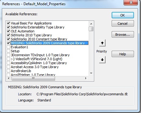

The macros stop at a string command. strResFilename = Left(strFilename, Len(strFilename) - 7)
And a compile error says “Can’t find project or library”.

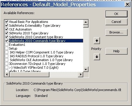

Looking at Tools/References I see “Missing: Solidworks 2009 Commands type library.”
Comparing this to the 32 bit computer “Solidworks 2010 Commands type library is selected.  I assume this is part of the problem.

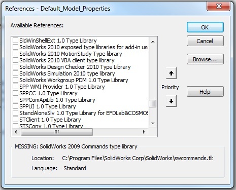

However I do not have a Solidworks 2010 Commands type library available on the the 64 bit computer.
I don’t know what to look for or where to find it.  Am I on the right track with the references?
Is there an easy solution to my problem?
