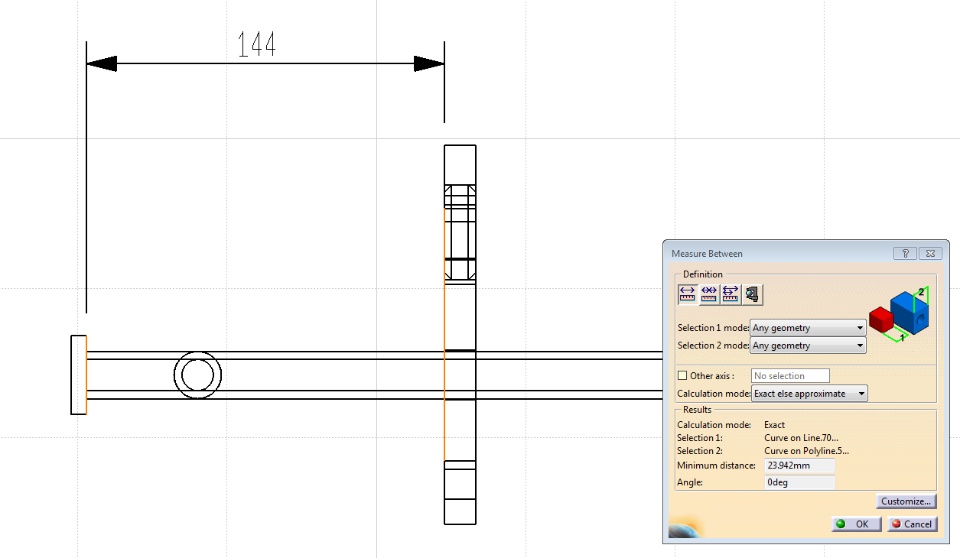

Any ideas on why P&G takes so long? Or another way to rename files in mass without losing references? - I can save SW drawings as dxf or dwg and open them in Catia. The sheet size doesn't carry over and the drawing dimensions import, but aren't correct anymore. I think the units are converting somewhere.
dxf opened in Catia

If I open the newly created dxf or dwg in SW, the dimensions are wrong in a different way
