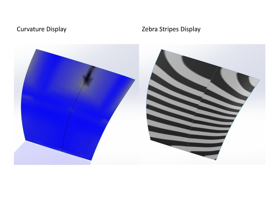

I am trying to make sense of the Curvature Display and Zebra Stripes in evaluating surface continuity but I don’t know how to read the results.
I know with Zebra Stripes they have to meet (black with black and white with white on both sides of the mirror plane in my case) but I don’t know how to read the Curvature.  I see a dark spot and  I know something is not right but I am not sure what it is that is showing. I dug around for info but I couldn’t find a lot.

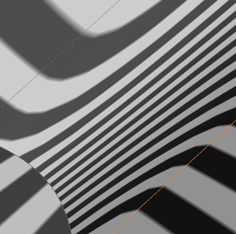

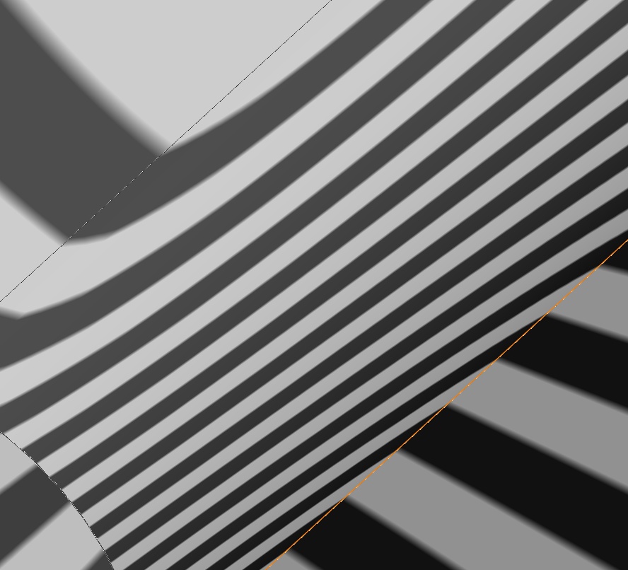

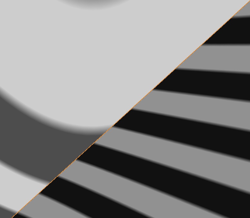

So, there are 3 types that Solidworks can do (C0, C1, and C2).  C0 means that the edges touch and the zebra does not show any connection between the stripes as they cross the boundary.  C1 means that the surfaces are tangent and the zebra will show the stripes touch at the boundary but don't really continue, almost like you broke a toothpick.  C2 is curvature continuous and the zebra will show the stripes being continuous across the boundary.
See attached images of each.
What you show appears to be C2 at the bottom, but loses it and becomes more C0 at the top.

In addition to Eric, black on the curvature display is a zero curvature (flat)

  I was refering to the curvature display, not zebra

There are settings for the Curvature Display buried deep within Tools > Options which is described here
http://help.solidworks.com/2014/English/solidworks/sldworks/t_setting_curvature_values.htm
You'll need to change these numbers with trial and error, you should eventually achieve a more readable curvature display.
