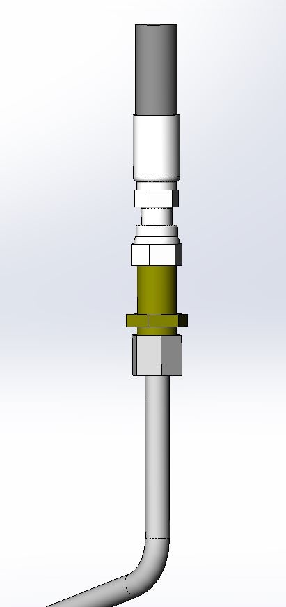

I would like to be able to connect multiple fittings together in the same route. Specifically, I would like to connect rigid tubes (part files) to a routing fitting, then connect a second fitting that which will start a hose and include all of this in a single route.
I've attached a screenshot of my situation. Currently, the upper white crimp fitting and then hose are the only components in my route, but I would like all four of these components to show up in a single route.
The reason I want them in a single route is so I can have one route for each circuit. Which will keep things organized for reuse as well as making circuit drawings.
The main problem I am running into is that I don't know where (if anywhere) to put the CPoints on the tube and middle (green/brown) fitting.
