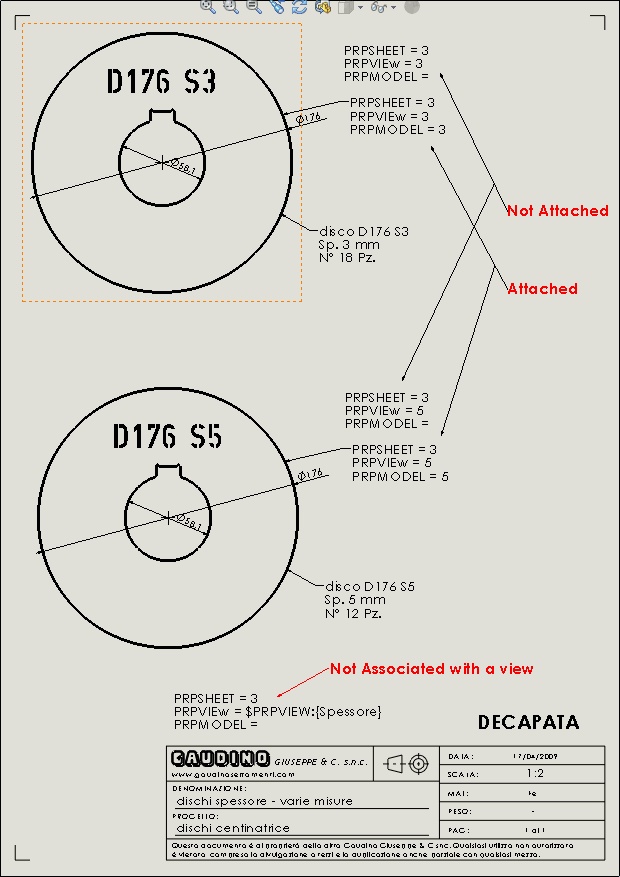

I tried to do a Configuration specific Property called "MyDim", andfor that "Dim@Sketch1" works. Too bad that the property assumes thevalue of the last config I loaded, for all the configurations.
i.e. I made two configs: the first with Dim=1, then one with Dim=2.

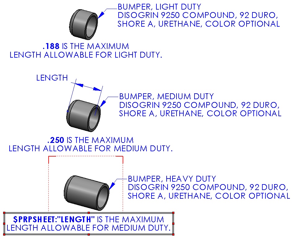

Then I save, put a view for each configuration and put the note\\\$PRPVIEW:"MyDim" into each view.
As a result, both notes show a "2".
