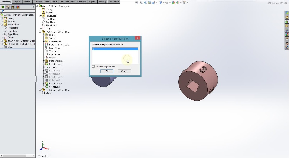

Kindly find the attached 2 parts & carefully watch the video.

So in an assembly, it should list all configurations of B if I try to insert B on A - config 1.
And similarly if i have B - config 4 & I try to insert A on it, but amazingly it lists multiple instants of configuration names.
Next I tried to insert part A on part A - config 3 existing in the assembly & the part A which is being inserted, frequently changes between the configurations 2 & 3
Same is not the case while inserting part A on another part A with config 2
