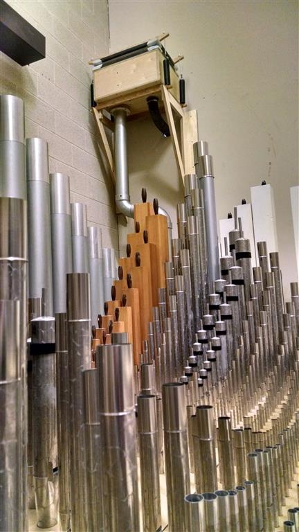

This is the final product: (Here is about 6 or 7 sets of these pipes, each set with 61 pipes)
